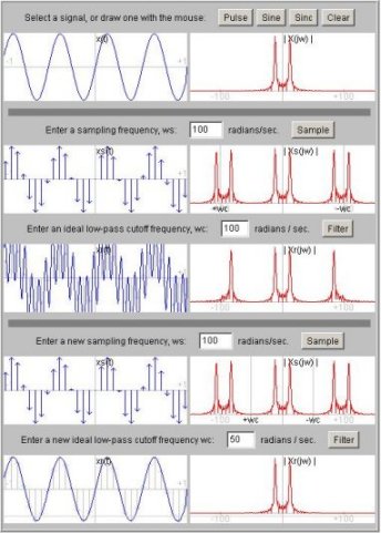

    Mar 2003
    Uranus
    There are many ways for information to be encoded in an analog waveform, two are common, time domain (video), and frequency domain (audio). Since aliasing misplaces and overlaps frequency components, it directly destroys information encoded in the frequency domain. In the time domain, Using no filter says the value of each sample is identical to the value of the orignial signal. In other words, it has the perfect edge sharpness. However, you also get noise. The amount depends on the signal. No guarentees that it is trashed.
    Most of this is not true. I guess you don't believe that sampling changes the spectrum. The fact that people are insensitive to audio phase does
    not mean audio is represented in the frequency domain either
    I guess I'll have to go find a picture
  21. Originally Posted by FOO
    Foo,
    Sampling does change the wave. Can't say what I believe. I'm still learning. However, I'm just paraphrasing sources. I'm not making it up. See this one about page 45 to the end.

    OK found picture.
    1. Original signal with spectrum
    2. Sampled signal with spectrum . Note extra crap
    3. Low pass filter with too high cutoff. Note signal is garbage
    4. same as #2
    5. Correct low pass filter . Signal now Happy
  23. FOO,
    I like your picture, but seems we are talking about 2 different things here.
    Your picture describes a problem with Digital to Analog conversion. A problem for your DVD player. I'm talking about Analog to Digital conversion. A challange for your capture card.
    This is my take on your picture:
    1 - The analog Wave
    2 - Sample it. Now we are in the digital realm
    3 - Filter out the samples to get back to analog (DAC) Filter was not 'tight' enough around the sample frequency.
    4 - Same as 2
    5 - Good Digital to Analog Conversion.
    How 'bout ADC ?
  24. Member
    Mar 2003
    Uranus
    The only reason for the picture is that I thought I heard you say
    that a LPF was not necessary or was optional.
    I guess you are trying to figure out what the horizontal sampling rate
    should be for a VHS tape capture . Is this true ?
    I regularly see statements claiming that sampling higher than the cutoff
    of a VHS tape or a Tuner are useless, and it's obvious to me it's not so
    just by looking. I was also trying to address some of that.
    There is more to it than just Nyquist.
    Oversampling helps even when it's theoretically not required.
    Before I start a war , I'll say that any improvement with oversampling is
    minimal.
