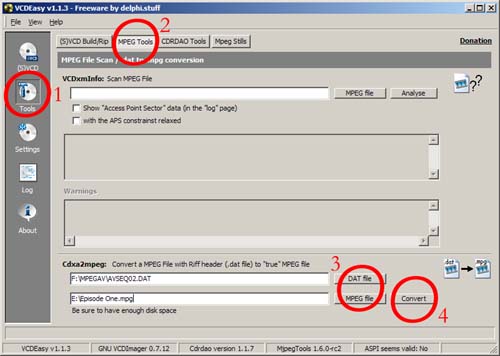

1. On the left hand column, hit Tools.
2. When the new window shows up, hit MPEG Tools.
3. Hit DAT Files to browse to the location of the MPG DAT file on the VCD, which is usually in a directory off the root of the CD called MPEGAV. All the files will be called things like AVSEQ01.DAT, AVSEQ02.DAT, etc. Then hit MPEG File and browse to the location you want the MPG file to be saved in. Enter the filename you want it to be saved as. Don't forget to put the ".MPG" file extension on the end of your filename.
4. Hit Convert and it will translate the DAT file into the original MPG VCD file. There is no way to batch convert in VCDEasy - you just have to convert the files one by one. On the good side, it's good at doing this and can get the job done reasonably fast, even on slow machines.

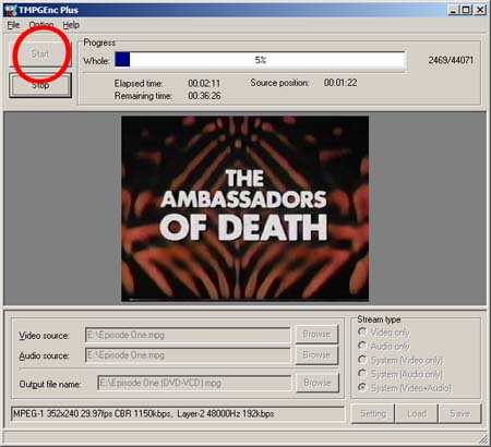

You can use the trialware version of TMPGEnc to do this as well but I'm using version 2.55 of the full version, known as TMPGEnc Plus. We're going to use TMPGEnc to convert the audio of our files to 48000 Hz. This will make them suitable for burning onto a DVD.
When you first start up TMPGEnc, it brings up a wizard window, just hit Cancel - you won't be using that today.
Now go up to File and select New Project. A window will ask you if you want to reset the current settings, just say Ok.

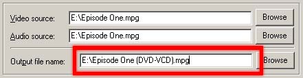

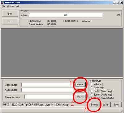

1. Click on Browse and find the MPG file you want to convert. It'll use the existing audio from this file so both the video and audio source lines will be filled in once you've done this.
2. Browse to the location you want to save your new MPG file to - remember to give it the ".MPG" file extension and call it something different from the original MPG file.
3. Click on Settings.

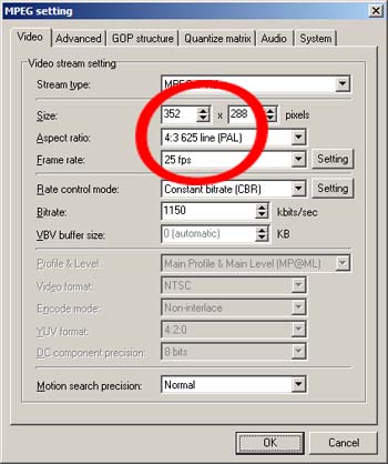

If you're translating a PAL source (UK, Japan, etc.) you should make sure you set that up under Settings by changing the size of the video to 352 by 288, the aspect ration to 4:3 PAL, and the frame rate to 25 fps. If you're translating an NTSC source, you shouldn't have to make any changes, as it's set for NTSC by default.
One last change to make if you're working with a PAL source is to change the aspect ratio to 4:3 PAL under the Advanced tab as well.
Now for both NTSC and PAL users, continue by doing the following:

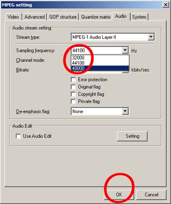

1. Use the pull down menu for the sampling frequency and change it to 48000.
2. Hit Ok.
Press Start and the file will start converting. This will take some time for large files and slower computers.

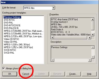

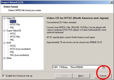

Anyway, to convert a file in Video Editor, start it up and it'll begin with a wizard, much like TMPGEnc does. Just hit Cancel - we won't use that today.

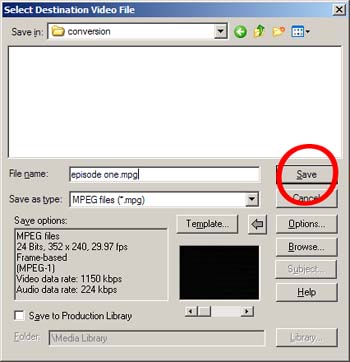

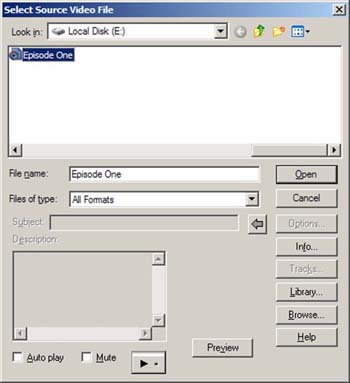

Go to File, then Convert, then Video File. Then you can browse to the location of the MPG file you wish to convert to DVD-VCD format MPG.

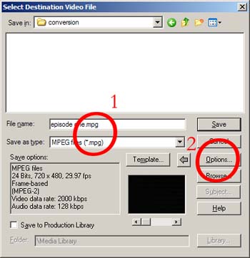

1. Make sure the file type is set to MPG (I think it defaults to AVI), then browse to the path you wish to save to and put in your filename. Make it different from the MPG you're converting from and make sure you put the ".MPG" file extension on the end of the filename. If you must use the same filename, make sure you're saving into a different directory from that of the original file.
2. Hit Options.

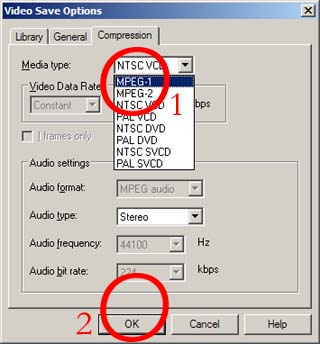

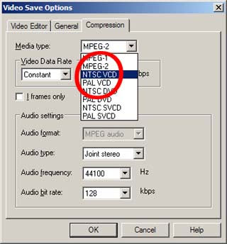

Under the Compression tab, change the Media Type to NTSC VCD in the pulldown menu, or PAL VCD if you're working with a PAL source.
1. Now change the Media Type to MPEG-1.
2. Hit Ok.

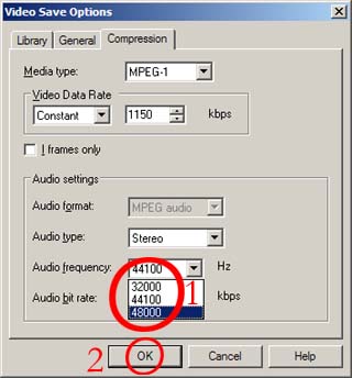

1. Change the Audio Frequency to 48000 Hz.
2. Hit Ok.
Having returned back a window, click on Save, and the conversion will begin. It'll be slow at first, but you'll probably find that somewhere at around 3-4% it'll pick up speed and zip through to the end. It's spending the first little bit converting the audio and the last little bit multiplexing the new audio to the existing video, which isn't being changed. It should take about 15% of the time TMPGEnc takes to perform the same process.

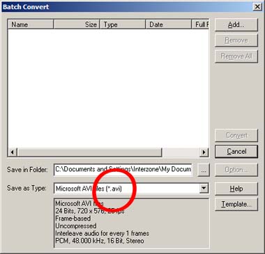

You can also do batch conversions of files in Video Editor. To do this, start out by loading up Video Editor, cancelling out of the wizard, going to File, Convert, and then Batch Convert. Again, change the file type to MPG, as it defaults to AVI.
