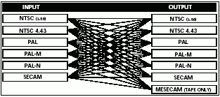

    I just ordered the Samsung SV-5000W. Should be here on 5 May 2004. I have looked at the operation manual.
    I guess they are saying it can output MESECAM only from tape.
