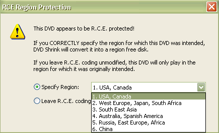

    However DVD Shrink could handle it alone, straight from the disc
    It came up with this unusual message and removed RCE for good.

    heya Tompika, how do i insert image here?
    I tried what you said with DVDshrink and it gives me a message : Failed to read , The reason is: Copy Protection Error - The read failed because the sector is encrypted.
    I tells Ya's Fox is doing something new with their regional coding![/img]
