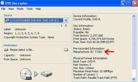

    As an alternative, you can use DVD Decrypter to check the media ID...just start it and load a disc...
