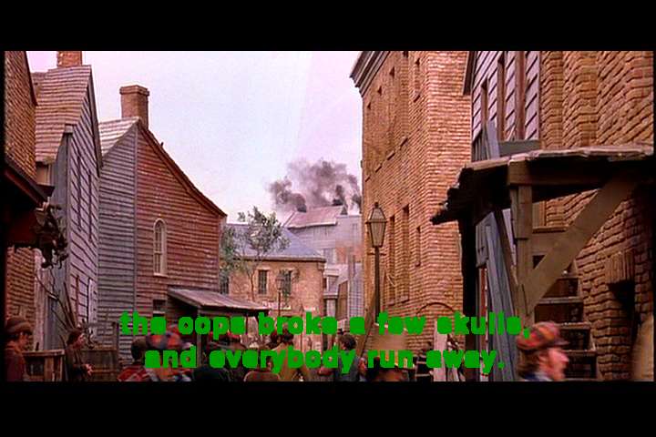

    Here is a picture of the subtitle with problem I got with DVDShrink. It is strange that some movies I copied don't have this subtitle problem , and some have. When play this movie on TV, the subtitle changes to black color and almost invisible.
  6. arrowhead
    That doesn't look like a DVD Shrink problem it looks as though you created the IFO's with Ifoedit.
    Did you use Ifoedit prior to DVD Shrink?

    Oh yeh, that must be the reason. I used IfoEdit to generate video_ts files for this movie. I recall that the copies which don't have this problem were not edited using IfoEdit.
    But why? how to avoid this if I have to use IfoEdit to create IFOs?
