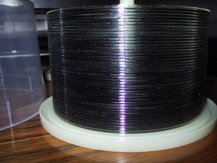

All of the disks (all 100 of them) have what appears to be like drops of glue or something on their sides...I have never seen anything like this. Is this normal? I think I remember reading here people talking about this, that their Ritek G04 from Meritline have bad sides. I thought ok well; if they burn fine I don't care too much. So, I burned 5 disks at 4X using external USB 2.0 LG GSA 4040B and Nero 6.
First of all they don't seem to burn at 4X. It takes around 20 minutes (give or take a few minutes) to burn a full DVD. That comes out to about 202 MB per minute, which puts it in the neighborhood of about 2.5X, but clearly not 4X. Why doesn't it burn at 4X?
Second, the disk played in both DVD players (stationary Sony and computer one), but I have noticed that the movie skips during the play. One movie started skipping in the beginning and at the end. Another one skips closer to the end. Why does that happen?
For the record, I never had a problem with my DVDs skipping and I was using cheap CompUSA's DVD-R for like 70c each 1X that for some reason burn at 2X in Nero 6.
So, what do you people think is going on here? Why doesn't it burn at 4X and why all the skips?

however, I have the same glue problems on the side that others seem to have ...almost like there's too much glue and extra got squeezed out...
the surfaces all look very good ... the only defects I see are on some there are a few very tiny nicks in the burn sufrace at the very outer edge, outside where it looks like it would burn (e.g. on the smooth margin of the outer edge)

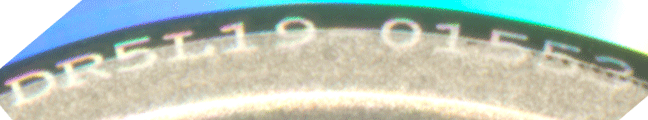

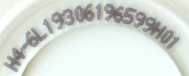

I scanned these from the disk. Maybe it will help your contact in our quest to find the answer about the grades
here's the run numbers
@ defence,
here's the other numbers that are truely very small, thank god for scanners and Photoshop
BTW, these are Orange top with the stencil mountain scene

...so, this is what I received from mertline...it's hard to tell from the pic (best I could do esp at 50k max) but the glue thing bothers me a bit ...
"As you ramble on through life, brother, whatever be your goal - keep your eye upon the doughnut and not upon the hole."
@ stiltman...thanks for uploading those pics..they look very neat and clean. I'll find out if the hub coding means anything or the media id's in this particular case. Your scanner does a nice job....I don't have mine hooked up because I never use it. I purchased it about a year ago..and have only used it a handful of times...and a few of those times was to upload pics to this forum.....lol.
@ DaveS...I wouldn't be too concerned about the sides..that isn't gonna affect the disk...if they burn and play flawlessly..i'd live with it..but if it really bothers you..send them back to meritline immediately..get your money back..and purchase them somewhere else. As I said...that's really sad that meritline is obtaining lower grade Taiyo's and Riteks and selling them for about the same price as the top notch disks.
thanks - that was kinda my thoughts...I don't think it's actually worth the $ for shipping to return them since I think they will burn / play ok (2 of 2 so far no read errors & seem to play fine), so I continue using them & will just keep it in mind for next time...thanks for the commentsOriginally Posted by defense"As you ramble on through life, brother, whatever be your goal - keep your eye upon the doughnut and not upon the hole."
