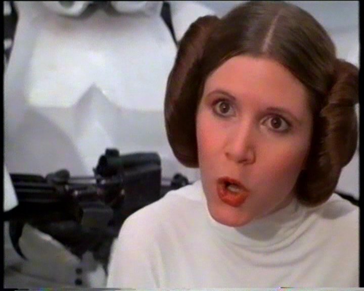

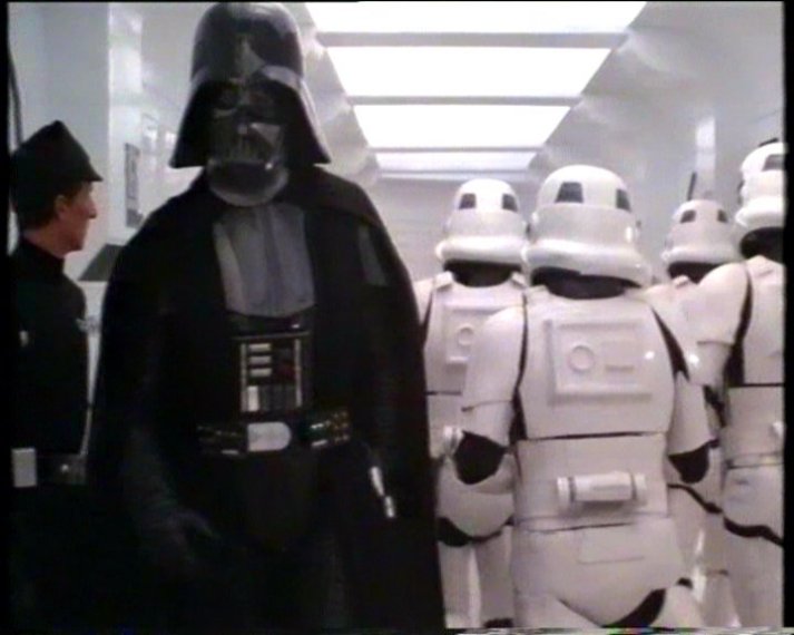

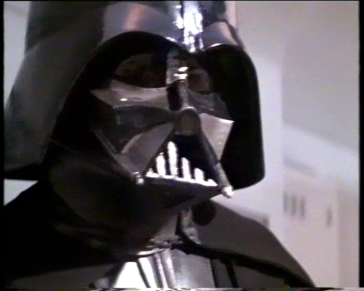

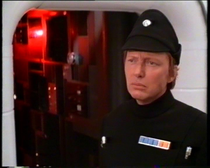

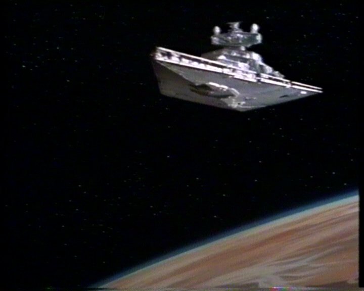

    Okay, I don't have a lot of time here, but I've hooked up my JVC to the ADVC-100 and the examples following are a marked improvement on the former proceedure.
    Please bear in mind they're taken from a (pretty good quality) VHS tape, so aren't goingto be anything like the pictures I posted of the MiniDV footage.
    But don't have to tell you experts that, do I?
    However, can you believe my VCR doesn't have compsoites out?
    What kind of shit is that?
    Plus, it has two scart leads, one in/out and the other in only, which means I can't watch the footage on the TV at the same time as I 'capture' it to the PC (and ultimately compare as I 'capture').
    Bastard thing.
    So, I've had to stick one of my 'scart to composite' adapters in, and run the composite leads from there into the ADVC.
    You'll notice there is a definate tinge of red still, but I'm leaning more and more towards the fact that this is a result of the shitty scart adapter I'm been forced to use.
    More later.
    Will

    The last one looked very red anyway, although Fulcri, our resident Star Wars expert, might be able to confirm this
    I'm of the firm belief my scart to composite adapter is to blame.
    Will
