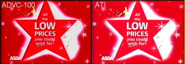

But, if I've run the file through TMPGEnc and the resulatnt mpeg is saturated and dark (-er than the file produced by the ATI card) it can't be the codec that's at fault, can it?
It must be something happening with the canopus codec within the unit, surely?

I think you just about got it when you say:Originally Posted by Will Hay
"Or do you mean that by lifting the saturation and brightness, once the ADVC lowers them they will be higher than if the external processing box wasn't there and therefore be set at an accetable level?"
Since we know the Canopus ADVC-100 will over saturate and darken the image we take that into account by reducing the saturation and increasing the brightness BEFORE the signal gets to the ADVC-100 by using something like the SIMA. Then the Canopus ADVC-100 will pump up the saturation and darken the image to a "normal" level ... if you have properly adjusted the signal ahead of time.
It would be hit or miss but once you got it right I would think that the same settings would work with most good quality sources.
I agree that the errors (the oversaturation and darkening of the image etc.) are being introduced internally by the ADVC-100Originally Posted by Will Hay
However ... having said that ... using a different DV codec on the computer to DECODE the signal might make a differene.

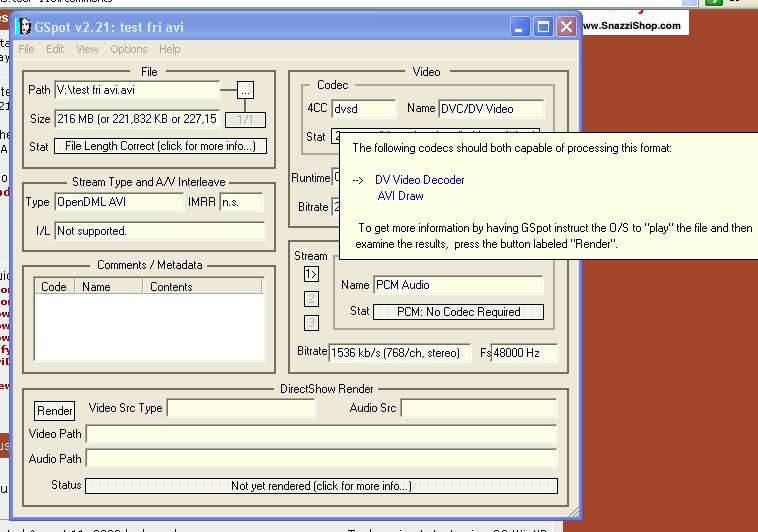

I just downloaded and installed gspot, and for the hell of it, I've done a test run on a capture Ive just done with the ADVC-100:
