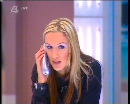

Hmmmmmmmmmmm................
I think you're getting to where you need to be with the Canopus, but you're not there yet.
The TV/VCR caps you posted look shitty compared to mine and others. Let's see what the captures are like once all the cables are sorted and the source is cleaned up a bit i.e. stright from digibox etc.Regards,
Rob
Yeah, but don't forget the top gear captures were from a shitty signal, one I would never dream of capturing from.Originally Posted by rhegedus
I'll upload some captures taken direct from my TV via satellite as soon as I can.
Like I say, they look much darker on the monitor and not at all a representation of the final output DVDr.
