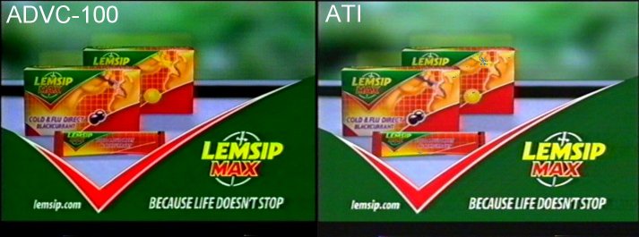

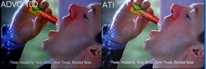

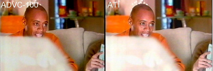

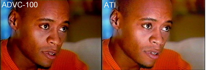

    I'm having issues with the colour saturation of the ADVC-100, specifically the colour 'red'.
    It was suggested to me, in order to correct this saturation problem, to try 'capture' with scenalzer, and specifically to 'capture' to a Canopus Compatible DV File.
    I did this, I still got the saturated red.

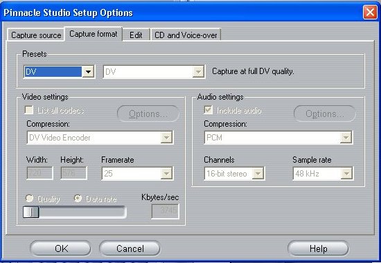

    I normally capture with Pinnacle Studio 8.10...
    ...so now feel the problem doesn't lie with my 'capture' software.
    It was suggested to me to use the s-video adapter cable that came in the ADVC box, rather than plus my composite directly into the front of the unit.
    I did this, nothing changed.
    It was suggested I switch composite cables.
    I now feel I've eliminated everything I can with regards the actual ADVC-100 device - please feel free to correct me if I'm wrong.
    Well, actually, that's not true. I haven't had chance to hook up a VCR directly to the ADVC-100 but as I plan to 'capture' a TV signal directly from my TV (via an output adapter on a scart connector) it doesn't matter.

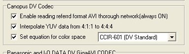

    It was suggested to me to playaround with the settings in TMPGEnc, specifically these...
    I did this.
    I checked just the 'interpolate' box only and still had saturated red
    I checked no boxes at all and still had saturated red
    I checked the 'set equation' box to DV box only and still had saturated red
    I feel, to the best of my ability, I have covered all angles with regards encoding (other than altering the brightness and red colour options in TMPGEnc, within the 'advanced setting' tab which I don't really want to do, I want the ADVC to work as it does for others).

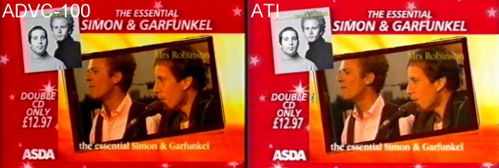

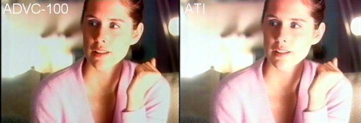

    At this point I began to feel like I was expecting too much from the ADVC-100, and recorded a small amount of TV to VHS and them pumped the signal into my computer....
    Firstly, with Pinnacle Studio 8.10 via the ADVC-100
    and secondly using Virtualdub at 720 x 576 using the PicVideo MJPEG codec at quality setting 19/20.
    The following screenshots show the outcome, all encoded with TMPGEnc at 8000CBR.
    In all cases, the ADVC-100 is on the left, the ATI capture on the right.
    As I say, I'm no expert, if there's any settings I've not qualified please ask and I'll do my best to add them.
    Finally, please refrain from posting until I upload all the pics, it might take a little while

  4. Member rhegedus's Avatar
    on the jazz
    Good work!
    Now for the pics:
    Either the Canopus captures slightly darker or the AIW captures slightly lighter.

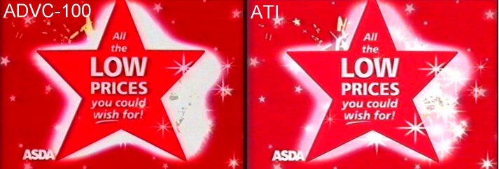

  6. I am far from an expert, but the most interesting picture to me is the red star. All the detail is lost in the glow around the star with the canopus. Since that detail has red in it, and you think the red is getting saturated, wouldn't you see the red even more with the canopus shot? Maybe it is a brightness/contrast problem and not a saturation problem?
    Of course they are not the exact frames being compared either. Just a thought.

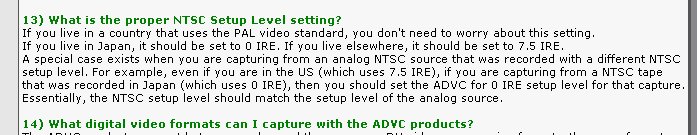

    In that case, just set your IRE to 0, instad of 7.5 on your unit.
    I have mine set to 7.5 IRE ... (dip 2 is set to ON)
    For you, try it at: 0 IRE ... (dip 2 is set to ON)

    I find the star to be interesting also. I'd expect the white on the ATI to wash out the details because the brightness and contrast seem to be higher on the ATI. Is this really the same pic ?
    It may well be a DV codec thing. Not only does the red bleed, the green does too. It's just less noticable. From what I can tell, it's not clear what subsampleing your box does. It may well do 4:1:1, just at a PAL frame rate and size. The assumed problem with this is that you have 1/2 the color from the start. Then when the decompression codec provides the color in 4:4:4 or even 4:2:2 (I'm not sure what happens here), it has to use 1 piece of color data to get the color for 4 pixels. When you go to mpeg, the subsample changes to 4:2:0 which means we only really keep the color for every other line. The method of going from 4:1:1 to 4:2:0 is important because the worse case would be 4:1:0 or about 1 piece of color info for every 8 pixel block. This is indeed made worse by interlace because the lines are offset during movement.
    I can't say I have much experience with this problem. I use a cheap BT card, and I havn't noticed on my DVcam. I'm surprized VHelp did not say more about this. Maybe that's not the problem. Could also still be the connectors. However, if the color signal was delayed I'd expect a shift (red moved to the right). If it was a composite (comb/notch) filter thing, I'd only expect bleed in high frequency (line edges). It's my understanding that the color signal in PAL is only mixed with the highest frequencies of the luma.
    Anyway, can you produce the color bars from the unit and feed them back into the ADVC and ATI and post the results. That should let people tell which device has the hue/satuartion/whitelevel and black level set correctly. Do it for both IRE settings on the ADVC capture (3 pics total). Don't run them thru MPEG.

    Any possible way of doing another STAR picture but this time with both captures at roughly the same point in time. I am bothered by the lack of detail in the white area surrounding the STAR in the CANOPUS picture but it clearly is not from the same moment in time as the ATI capture ... you can tell that the white star IN the READ STAR (the one in the bottom right leg) is smaller in the CANOPUS pic meaning one pic is behind the other ... and this might explain the differences in the pics.
    All in all I don't think the CANOPUS looks bad at all and after all you do have (or should have) ZERO sync problems now which might be worth it even though the ATI picture might be more pleasing to your eye.
    - John "FulciLives" Coleman
    For some reason it was a bit of a struggle to get this one spot on, I'll see what I can do this week.

    Anyway, one thing I have noticed from the screenshots is they don't really give a fair representation of the problem I'm experiencing.
    What I mean is that when you watch the footage through, once the results produced by the ADVC-100 and then with the ATI the colours look much, much more natural with the ATI.
    Much more.
    Maybevhelp is right, maybe I've become too accustomed to the ATI captures but I know one thing; I prefer the ATI hands down at the present time.
    This was suggested to me yesterday, before I did my screenshots, so if I remember correctly what you see is a result or the IRE set to 0.
    I was under the impresssion this setting was irrelevent for PAL users but like I say it doesn't seem to make a difference.
    This is from the Canopus website:
    I'll do some testing on it though.

    Thanks, but I do worry these do not reflect the overall problem I'm having, and may be misleading to any prospective ADVC-100 buyers.
    Please folks, don't be under any illusion - the quality I'm getting from the ADVC-100 at the present time (without any colour adjustment in TMPGEnc) is unacceptable to me.
    I agree it doesn't look too bad in the screenshots but trust me, its far more noticable during playback.
    Jeesh!
    I never noticed how far out those two frames were until you pointed out the white star in the btm right leg

    Originally Posted by acanthis
    One small thing, I have found that the best codec for rendering the video on the PC is MainConcept as opposed to the default Microsoft supplied one.
    The tests I did were simply a transfer via Pinancle Studio 8.10, I didn't do any rendering to an avi.
    Would I right in thinking that, with this in mind, The only codec used was by the ADVC itself?
    I appreciate if I render/edit within Pinnacle and save as an avi then I need to use a codec (I can't select anything other than the one shown below from within Pinnacle) but if I'm just 'capturing' then I'm not altering the quality at all?
    This is the only DV codec option I have in Pinnacle:
    I'd like to explore the possibility of a different codec though, can anyone shed some light on it for me, I think I'm confusing myself

  24. The Old One SatStorm's Avatar
    Hellas (Greece), E.U.
    I can't judge from stills, that's for sure. Maybe some others can.
    If I have to judge from those stills, then my only conclusion is that I'm more than happy with my asus 7700, my hauppauge win tv primio fm and my new kworld mpeg 2 PCI station....
    Anyway, since this works for you and you are happy with it, don't listen anyone! Just do your stuff the way you wish!

    Actuualy Rob, now the mention it...
    ... I did plan to capture directly from Sky TV, but then realised I wouldn't be able to compare like for like frame grabs as I wouldn't be able to shoot the same footage twice with the ATI.
    I did a few 'captures' with the ADVC and noticed, during live 'capture' that the colour saturation was worse.
    It also had a bleed to the right hand side which, whilst (very slightly) apparent on the TV was greatly emphasisied by the ADVC.
    I 'captured' some footage from Sky Sports News, and if you have tis channel you'll know there's a lot of red in it, in particular the time in the bottom right and the infobar (scrolling text).
    I decided to use TV commercials as my test as I felt these were more natural.
    That's why I don't feel the images I've uploaded are a fair representation, I could have uploaded examples which were a lot worse, I wish I had now, I could have compared them to the ATI.

  27. Lost Will Hay's Avatar
    Oct 2002
    Buggleskelly Railway St.
    Hi Sat,
    That's the problem, I'm not happy with it
    I expected more from the ADVC when compared to the ATI and want to improve the 'capture'.
    I think I'll take some more screenshots of particularly bad examples (I've been rather conservative with what I've uploaded so far) and show my concerns a little better.
    Will
