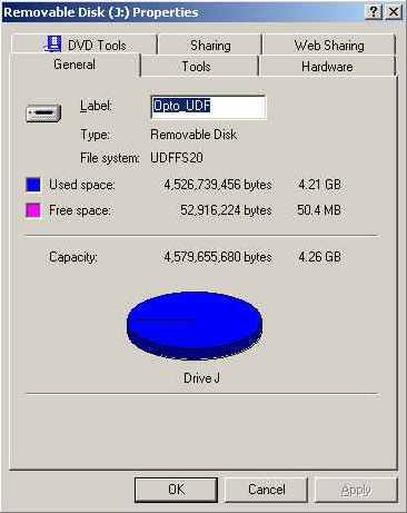

Well it is all very strange. I have a UK E50 and I routinely get vro files larger than 4GB using FR mode. I'm using cheap MediR double-sided and Panasonic brand media.
Here's an image of the properties of the removable drive on my PC just to show I'm not talking bull. BTW, I'm using the RAM driver that came with my Panny burner (LF-M621).
Just had a thought. What's the formatted capacity of your discs? Have you formatted them in the Panny or on the PC? The one I've used here came preformatted, and as you can see the capacity is 4.26GB. -

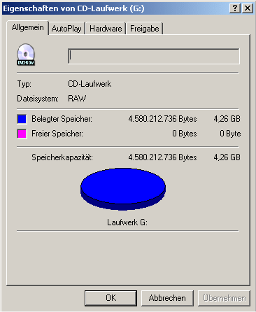

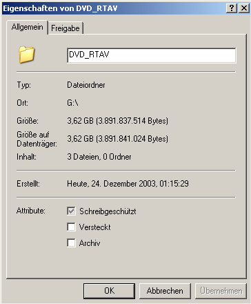

@bobones
Here is an image of the properties of my DVD-RAM drive
and here an image of the properties of the DVD_RTAV folder (same disc inside)!
PS. I don't have RAM writer, so I can't format RAM's in the PC. -
