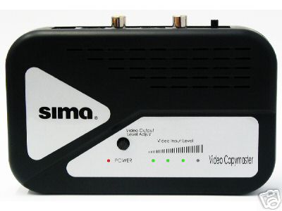

Though the SIMA is limited in its uses, I have found another one. It is an EXCELLENT device for super-compound-error'd video.
This device is primarily good at correcting dropped frames problems when the source is to blame. It's other corrections are minimal, as it is a psuedo-TBC or partial TBC. This part we already knew...
Now the new part...
If a full TBC causes more errors than it corrects (which happens when the sources errors are too compounded and the signal flaws are integrated with the signal itself) this weak device may be able to partially correct problems. The full TBC will try to correct everything, and take out good data in its wake.
I've got a set of tapes that have severe YCrCb damage. The BLUE part (Cb) will go all white if run through a full-field TBC. With the full TBC, the other signal problems are corrected, but the Yb signal dies, and the video is too bright, cyan-shaded and overall horrible. Without the TBC at all, the tape will jitter, have a watery texture, and chroma fluxing (red/blue errors).
But the SIMA Video CopyMaster... the SED-CM at least... it will slightly fix things, helping most mild jitter, calming harsh jitter, somewhat helping remove the watery effect ... all while leaving Cb mostly alone (though not entirely). This really weak TBC is good for this purpose.
Sometimes NOT being full strength helps.
So the SIMA is yet ANOTHER device nobody should be without, at least if you are into restoring video and sometimes only need mild corrections or a weak TBC.

	I have the "higher end" Sima SCC unit. It would be interesting to see if it reacts the same. I don't know if the basic internals of it are the same as the "SED" model, with just the added controls to tweak the processing. -n6nfg
	I would think so. The cost difference was only slight, so I bet you're right.Originally Posted by n6nfgWant my help? Ask here! (not via PM!)

 First, I have all three devices
 * SIMA SED-CM
 * SIMA SCC
 * TBC (TBC-100)
 Its ben my experience NOT to mix the TBC w/ an already-made TBC device
 or similar. It is ok to mix one w/ the above SIMA devices though.
 I have found that the SED-CM device proved quite good under normal video
 Analog capturing situations. The colors (most important to me) were a bit
 more "richer" I think is the correct word to use here.
 As for the SCC device, this one was semi good w/ helping to remove some
 of the Line Noise in my given Analog capture setup on my main pc.
