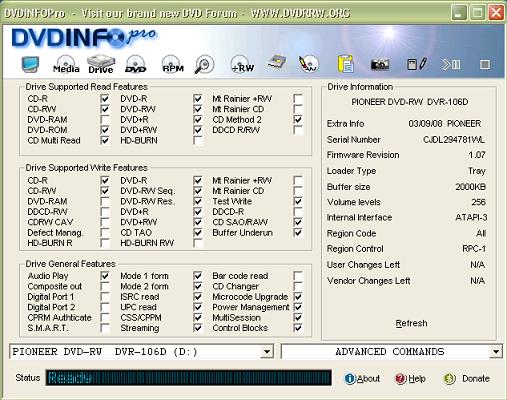

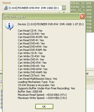

My 106 reads any DVD+R as its supposed to...

Update your firmware, dont use CMC media, use the latest Nero, RecordNow Max/DX, DVD Decrypter to burnYou stop me again whilst I'm walking and I'll cut your fv<king Jacob's off. -

Hey Tompika are you sure about DVD+R reading? I just read the tech page on it and it says it only reads DVD-R. Maybe I'm missing something. It can write to DVD+R but it can't read from DVD+R is what I'm understanding and I know mine can't read it. I'll look again!

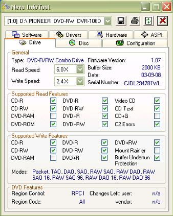

I'm running an IBM Thinkpad on Win XP Pro with the pioneer 106D in an external case. I doubt OS or PC brand has anything to do with the Pioneer 106D being unable to burn DVD+R in a format that can be read by most commercial DVD players, let alone itself !!!
Is it possibly firmware ???
