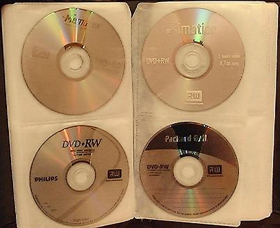

  11. Unfortunately I couldn't make a shot to show how scratchy they are
    - due to the reflective surface - but all of them are perfectly usable (writing/reading)
    Oh yeah, and I store them in CD wallets

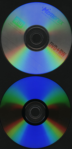

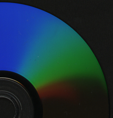

  17. The scanned discs as promised.
    Unfortunately the scratches do not show up on the pic but they are there.
