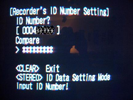

OK - Fixed the DVDR in 5 mins, but the HDD is seeing stars!!!
Got a remote and a service disc today (Thanks **). I fixed 1/2 my 510 in 5mins using the info from this thread. I had to use the 106XA drive from my 210, because the 111D drive doesn't work in either unit. Display says 'OPEN' when I power it up and the drive sounds like it's trying to spin up or close but never does. (May be a bad drive?)
Also, I still have the HDD ERROR msg on the 510.
What's the 'COMPARE' >********* line in the service menu? Seems like the unit lost its HDD info? Does the unit thinks it's ID is ********* instead of 0004.....? See Pic.
So, here's the scary question. If I re-enter the HDD ID info do you think I'll have to initialize (format) the drive? And since it's full of shows waiting to be archived because of the bad dvdr, that would be a disaster!
Any advice?
Thanks,
D-man[WarLlamas]
id_info_censored.jpgDman[WarLlamas]
"Angel's Lame, his hair grows straight up, and he's bloody stupid." BimBot Buffy, BtVS 05x18 'Intervention' -
Try reversing the cable on the 111D, sounds like it was on backwards. Which you shouldn't be able to do.......but it DOES happen.
When I was doing the experimenting on the 510 I have, I did the HDD swap several times. Including back to the original. After installing the original disc and inputting the CPRM everything was still there as far as recordings go. I had taken the precaution of transferring everything to my Media Center computer ahead of time. As I said I was experimenting - lots of conflicting info here and other places.
I think reinputing the CPRM will solve your problem. When I did these experiments I did not have to re-initialize the original drive. I THINK this occurs only when a blank drive is used, at least that is the way it appears to me.
Kind of strange about the HDD error occuring after replacing the burner though.

Update: My 510HS is back up and running! Thanks 'Ed', 'Kanipek', and the nameless others.
The HDD ERR was a bit of a mystery to me too. Apparently it was because I was a bit of a chicken with the DVDr replacement process. I unhooked the power to the HDD to be safe while screwing with stuff that I'm not supposed to screw with.
So when I hooked the HDD back up the machine thought it had a ID of "*********". All I did was reset the ID info again (with the drive powered up) and it's all happy again.
