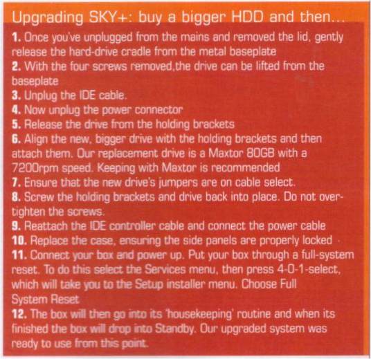

Hey all, nice to see people are trying to do something with this machine. I am also planning on buying 2 of these machines (one for me, one for my dad). I wondered if anyone already tried to put in a bigger HArddisc in this machine instead of the 80 GB. Is the OS the 5100HS uses on the harddrive or is it on the main hardware. Or would it be possible to make a Ghost image off the HD and put it on a new bigger HD.
Don't know if it applies the Pioneer, but I've read articles about upgrading SKY+ boxes:
Regards,
Rob -

Hi All
One of my users, in a Danish language only forum, tried to replace the harddrive in his DVR-5100H. But with no luck so far.
The original disk fitted are a Western Digital 80GB 5400rpm:
He tried with a Seagate Barracuda IV 120GB 7200rpm. The unit spins up the disk, but then says "HDD ERR" in the display. Onscreen its said something like "Invalid HDD Info".
From my point of view, it looks like the unit is shipped from Pioneer with data about the harddrive fitted and doesn't allow harddrives with other data to be inserted.
/Lars -
Maybe you have to replace the HD with one of the same model.
I did a google search for "western digital wd800lb" and found some.
Thanks Mike. -
Don't they use some special formating ???
Pinnacle Studio 8 and DV home video editing (ver.9 already home) -
Hi !
Has anyone tested the following :
Cloning the partition from the original WD hd to another hd, and then replace the hd with the new one ? (still cable-select pins)
Maybe the 'bad hd info' meens that somewhere on some sectors, some info about the hd are expected and were not found.
Maybe a sector editor would help finding the sector/offset the info is written.
The problem would be to find this info and then decode it (which info, which meaning, etc....)
Cybertof. -
