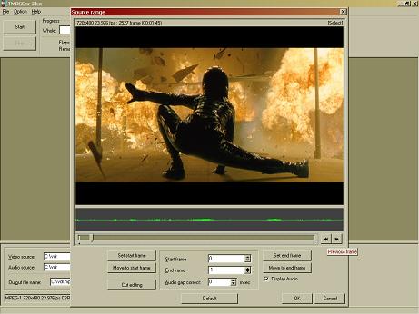

    I think I see the confusion. When you use the procedure I mentioned, we do not use the TMPGEnc MPEG tools. We use the main program to demux or convert to MPEG-1 or -2. Hope I was a little clearer.
    Virtual Dub mod running Matrix Reloaded VOB.
    TMPGEnc Plus running the frameserved video.
