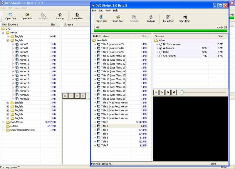

I re-authored a DVD to remove certain titles and burned the new DVD with DVD Decrypter. Unfortunately, what happens when I play back the re-authored DVD is that my player treats the menus as chapters. (i.e., it just plays the menu for 30 seconds and then goes to the next menu, etc.)
I can't seem to figure out what I'm doing wrong. I've attached a screen print. I noticed the original disc has folders (menus, main movie, extras, etc.) but the re-authored DVD does not. Is that the problem?

that's exactly what's supposed to happen. when you re-author in Shrink you lose the navigational functions of your menu(s). they simply play back as short titles (movies). if you want a workaround read my post here...
https://www.videohelp.com/forum/viewtopic.php?t=185976&highlight=
good luck.
