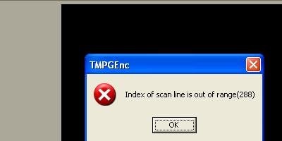

  1. k jus reformatted had to install a fresh new copy of TMPGenc and already getting errors. First dvd: audio was outa sync. 2nd: run vdub mp3 freeze, come up with 141032 bad frames.. thats the whole movie? So i try another AVI and i get this error..
    Is there any other way to convert AVI - DVD without using TMPG just tired of errors. Or is there a way to FIX them? Please anybody. Thanks

    It's your source files that are the problem, It's not TMPGEnc!
  4. It's your source files that are the problem, It's not TMPGEnc!
    Is there anyway to fix the source? I get this same error everytime i try and convert. IS there any other way to convert to dvd format. NOT using TMPG ? thanks

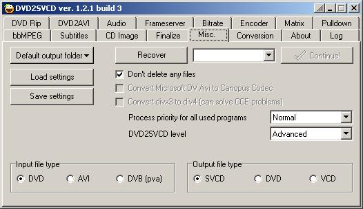

    I had been using TMPGE for several months and then all of the sudden I started getting errors when converting AVIs. I tried all the suggestions posted in the guides with no luck. Finally I stumbled on this guide and my problem is solved! Now I just use SVCD2DVD to convert my AVI files to MPEG. Even though this program uses TMPGE it does something different and I don't get the errors.
    Give it a try!
    https://www.videohelp.com/forum/userguides/111846.php

  8. Vanster, not wishing to be pedantic, but you mean DVD2SVCD... which is a different thing to SVCD2DVD.
    .. and yes, DVD2SVCD is a brilliant tool; much more versatile than the name suggests.

    Oops! My bad! Yes, the tool you want is DVD2SVCD and NOT SVCD2DVD. The guide I posted is still correct, however.
  10. 1 question though, i want avi to dvd ? is that still the same thing? DVDtoSVCD ?

    Try to load your AVI into VirtualDub and then frameserve from VirtualDub to TMPGEnc.
    I'm not sure why but this method will often "fix" problems with TMPGEnc in that errors you get loading an AVI directly into TMPGEnc will often go away when you frameserve to TMPGEnc from VirtualDub.
    The downside is that frameserving this way will slow down your encoding speed which of course means the conversion will take a bit longer.

    DVD2SVCD will do that conversion for you.

    FulciLives is right though - frameserving from VirtualDub often sorts out problems with avi's.
    Having said that, I can't recommend DVD2SVCD highly enough.
