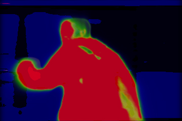

Well, to anyone who was interested, here's a frame of my "Predator" vision effect.

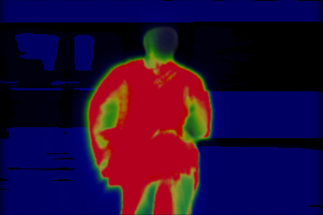

and here's another
Opinions? -
Nice, very nice! Glad you made it work.

What was the name of the effect used to create the red on the person?

Quick explanation of how I did it:
Basically I had the video of my actor running down a hallway at school. I imported the clip to after effects. Next, I traced my actor with the pen tool (using a ton of verticies). After that, I went through and adjusted the verticies to make sure they matched the motion of my actor in every frame (using keyframes). After that, I added the effect "Shine" (plugin by Trapcode). The shine effect has a ton of different lighting settings, one of them being IR (light colors red, darker colors blue/green). I adjusted the settings in the plugin so it looked good. After that, I took my now IR mask of my actor and placed it on top of another layer of the original video. I took the second layer of video and added some color effects, brightness effects, posterize, and noise to make it the background blue and distorted looking.
Thats about it. I'll be more than happy to answer any more questions about it.
