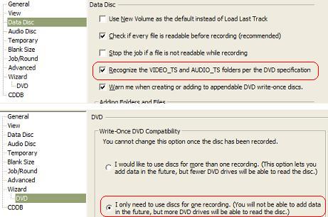

Install the pxEngine update
http://support.sonic.com/Downloads/files/pxEngine507.exe
Use these settings.
