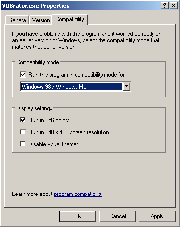

    you got XP?
    right click the Vobrator.exe and then click Properties and then the Compatibility tab and adjust the settings, finally clicking apply
    I have mine setup similar to this
