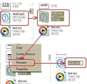

    Tom and Tommyknocker I know this sounds silly, but how do you change the file extention on a mp2 file from Canopus Procoder into mpg or mpa?
    Right click on the file, select Rename, then change the last three letters from "mp2" to "mpa".

  8. Member hiptune's Avatar
    May 2003
    Los Angeles, California
    In win XP, the flie extension is not part of the name of the file as you see it in "my computer" that part of the file name has to be changed in another way. That was the way it was in windows 3.1 I recall, but nowdays the display in windows does not show this info. So you cannot right click and change the extention.
    Thanks for the effort,
    Jeff
    Apr 2002
    The State of Frustration
    I do it in Windows XP all the time:
    Want to know how?
    Hello.

    Open up your folder- Click on Tools, then Folder Options, Then be sure to remove the checkmark next to "Hide extensions for Known file types" and all your file extensions should be seen. Then you can change them.

    Thanks for the tips on file ext. name change. I did it and the files are accepted now. But changing from m2v to "mpg" works out better than changing to mpa. They were not accepted in mpa.
