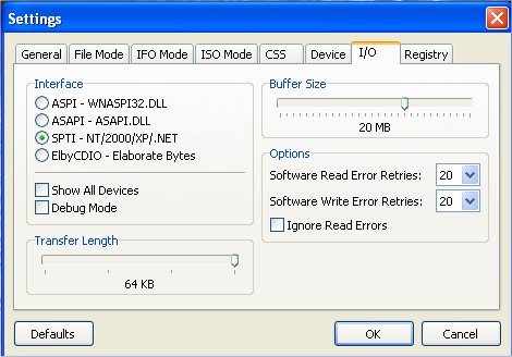

OK - installed Force ASPI
Tried:
ASPI - WNASPI32.DLL
SPTI - NT/2000/XP.NET
no change.

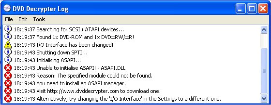

I this error with the others:
Any ideas?Regards,

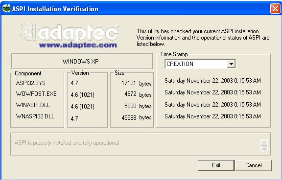

okay lets try this. in the files for ForceASPI, run dumpASPI, then run killASPI. Then Run instASPI and reboot. the first backs up the ASPI layer, the second completely deletes the current layer. the third will install it again. If you've already tried that no need to do it again. Open the Index Webpage included with ForceASPI. there is a link to download the Adaptec ASPI checker. download that and run it to make sure its all installed correctly. If it still doesn't wok you could try installing NERO's ASPI layer. Some people have trouble with Adaptec and find NERO's works better.
click the Tools link on the left and type ASPI in the search box and it'll bring up a link to it, or get them from Nero.com. they are free to use.
Tried all that:
Still no joy. I'm pretty sure it is something simple, I just haven't got a clue what!
Any offers?Regards,

from that screenshot I'd say you still have adaptecs new ASPI installed, the buggy one. Force ASPI should list it all as 4.6. but it's really looking like the ASPI isn't the problem here.

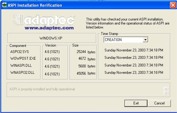

Just wiped the aspi layer and put in 4.6 - no change!
Regards,
