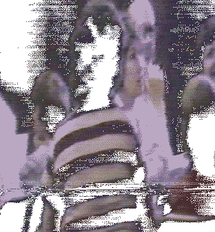

  7. Can you take a snap shot and post it so we can see might help.
    I'm betting he's just worried about the overscan area, which stores noise.
  9. i have quite a number of older beta tapes (some ranging 21 years), it could very well be " tape degrade" also. Exactly where on the screen do the lines appear? if its towards the middle, it was probably a bad tracking problem when the source was recorded or tape degrade. If it's towards the edges, that part of the pic might be matted out (like Lord smurf sugested) and that is something you would not have to worry about at all

  13. "LSchafroth" I do not think youcan remove the tracking line's it's part of the picture youcan remove noise but tracking is not noise. IF you can not fix the tracking use TMPG rencode and crop little of the picture. Also if you see a tracking problem on the computer at the bottom you might not see it on the TV. The TV does not display all the video.

    Here is a sample of the noise. Very old tapes. They were taken with a horrible VHS camera back then and dubbed to a Beta machine. All my Beta camera shots are super clean.
    Thanks!
    LS
    I couldn't get the image small enough so I reduced the colors to 16 with dithering, but you can still see the lines.

    Wow! That is not what the image looks like. Not sure what the forum is doing to it.

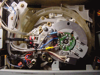

    Originally Posted by johns0
    There is one way to get rid of the tracking lines but it requires opening the beta machine and adjust the tracking posts closest to the head assembly,the thing about adjusting them is that you have to be very careful with the tape running and also to remember exactly where the tracking position was before its changed cause it probably wont play other tapes without tracking lines when retracked.
    Here is a pic of it. Which ones do I adjust?
    Lannie
  17. The first pic I do not see if any thing can help. Try clean the head or do some thing with the head's or buy a new Beta VCR from ebay and buy a good one. The second picture it did not get posted right can you please post it again to see it.

    Looks like you got what you paid for on that transaction. Sanyo's were notorious tape eaters and were MUCH lower quality than SONY. That's the only decks true Betaphiles use. I have several I bought off Ebay and from intown sources. I have techs in town who are still able to get parts and fix them. From the pic you posted, it looks like the heads are shot. Head clogging galore with badly worn heads.
  19. Member LSchafroth's Avatar
    Dec 2002
    Originally Posted by spiderman2k1
    The first pic I do not see if any thingcan help. Try clean the head or do some thing with the head's or buy a new Beta VCR from ebay and buy a good one. The second picture it did not get posted right can you please post it again to see it.
    If I was you once you fix the vcr problem capture with a ATI AIW card with MMC 8.1 to clean up the extra noise.
    This site is killing my images. 50K restriction hinders me from posting pics and it messed up the first pic so bad you can't amke out anything.
    I took the VCR apart and found the four tracking posts. I adjusted them for about 1/2 hour and now the tracking is perfect. Thanks for the idea!!!
    The picture is pretty darn good now. No more jumping, no more noise and hte tracks are gone. Thats without a good cleaning yet.
