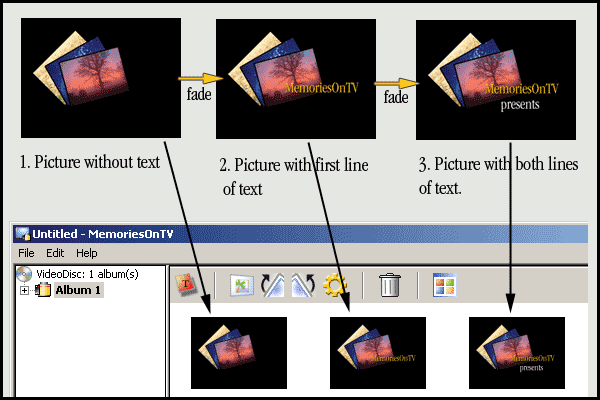

Trick 1: Text Fading
The FADE transition effect has an important property that makes it different from the rest. If you have 2 pictures that only differ slightly, the fading between them will only be applied to the region that is different.
This property can be exploited to do very elegant text fading, at the
beginning or ending of a slideshow.
The following shows 3 slides that are imported in sequence into
MemoriesOnTV, with the default transition effect set to FADE. When it
is played, you will see the words fading in line by line:

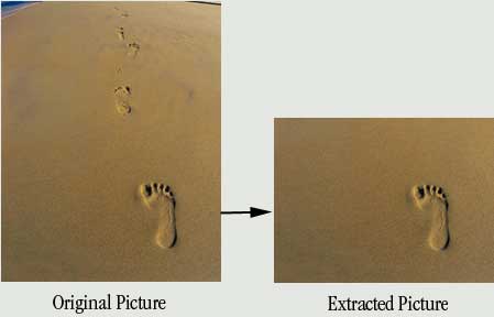

Trick 2: Subject Panning
The clever use of panning on a subject in a picture can tell a very
vivid story. Consider the following picture with footprints on the
sand:
Instead of showing the entire picture as it is, we extract out the lower
portion so that only 1 footprint is seen. The effect we want to
achieve here is to first show the lower extracted picture, pause, and
then pan upwards to show the remaining footprints.

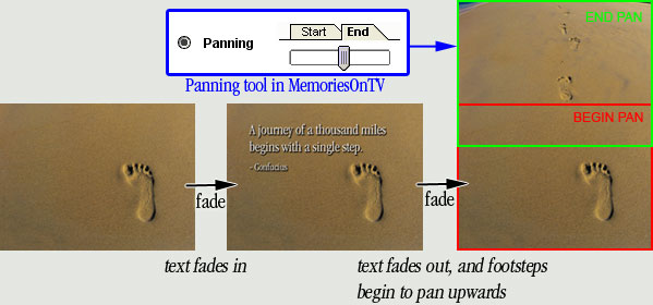

As an added effect, we can also combine the "Text Fading" trick above
to form the following sequence:
The panning of the footprints is controlled via the Ken Burns Pan/Zoom
tool in MemoriesOnTV.

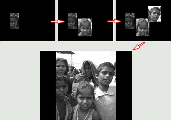

Trick 3: Progressive Picture Revelation
Instead of showing your picture all at once, you can show it piece
by piece. The following uses the FADE effect to slowly bring the focus
to the individual faces on the picture, until the whole picture is eventually shown:

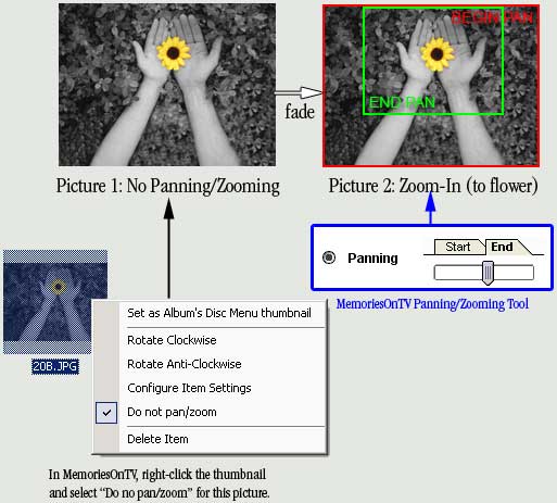

Trick 4: Motion Blur
You can achieve a motion blur effect by fading 2 copies of the
same picture, and setting the 2nd picture into motion using either
panning or zooming (Ken Burns effect).
The following illustrates how it is done:
Since the FADE transition effect happens when the Zoom-In on the 2nd
picture is starting, you will get a "motion blur" effect when the
camera zooms into the flower.
