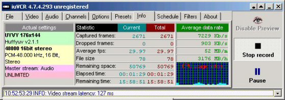

Attached is a picture of a "0" frames dropped screen shot.
I had to back the size down to 177 x 144 to get a clean capture. There may be hope for me getting this worked out yet.

I adjusted the Virtual Memory to 1152 min and max.
I installed the VIA Latency Patch from George E. Breese.
I am capturing at 720 x 480 with no lost frames.
I thought I had checked the capture after the PCI Latency Patch and was still droping frames.
I think I have figured out how to get the uploaded image to show also. Success breeds success.
The audio appears to be in sync also. I plan on capturing 70 minutes of tape to the Raid Array in 3 to 10 minute segments (Innings) and then moving them to IDE drive. I have just about enough space left on the Raid Array to capture 70 minutes.
