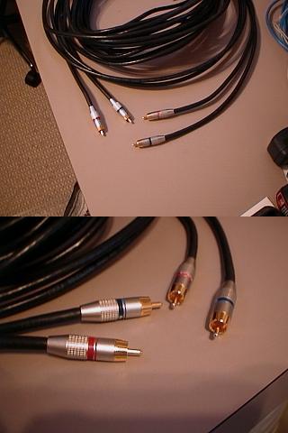

I'm going to agree with Innershield but you can make your own good quality component cables. I did this because I needed a longer run (about 10m) and purchasing 5 cables (component video and stereo audio) to run to the tv was really expensive.
Pick up quality RCA ends, Radio Shack sells them for about $5 a pair (an electronics house will be much cheaper). You'll also need a soldering iron and some solder. Stop in at your home reno place and get their best RG6 coax wire - even their best stuff should be about $0.50/m. A little soldering and in no time you've got your cables. If you're not familiar with soldering then practice a while joining wires together - takes a little practice getting good/clean connections.
This wire is actually good quality, low loss - just a little more rigid than commercial cables and doesn't take as much bending. I noticed no noise (static) with my home-made wires... -

@You_Are_Alive: A good set of cables, especially for longer lengths, can run into the hundreds of dollars. Many people don't have the funds and are looking for a cheap alternative. If you read the forums here I think you'll find a very high percentage of people running TV/DVD systems that are less expensive than what you are suggesting they spend on cables alone.
With a little care and a little time you can make your own. Below is a picture of my audio cable, the video's look identical but are currently being used.

oh my god squirreldip those cables looks so neat and look good, how do you solder, i am looking forward to making my own
Nice job there, SquirrelDip, good pics. But honestly, how long did it take you? Like I said, ppl with a necessity, like yourself will do it, if they know how. But the majority do not, and most, even me, don't need such long runs of cable. Shorter run cable is the norm, and thats still worth paying for. Never pay retail anyway, always shop around for the best deal for any cabling.

Time spent was about 20 minutes per cable.
The cable was actually purchased from an electrical wholesaler an was $36 CDN for a 1000 foot roll. I was helping a friend wire up a new home, we purchased a 1000 foot roll of RG6 and a 1000 foot roll of CAT5 ($60 CDN) - ran two CAT5 and one RG6 from the basement to every room in his home (with the exception of the bathrooms). Note that CAT5 can be used for telephone as well as network...
Soldering actually takes a little practice to get good at it. A cheap soldering iron should run about $10 and a spool of fine (thin) solder also about $10 (and the solder will last you for years...). Two hints when practicing: 1) heat your contacts slightly prior to bring the solder onto them. And 2) a third hand is handy, anything from clips to pliers to a small vice can come in handy. -
