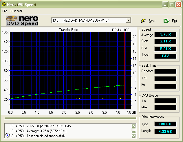

  4. I just wanted to mention that I also ordered this media. Actually I ordered it from Ecost.com, which from what I understand is 'connected' to PCMall. I ordered the BMI 25pk DVD+R 4x Media, and I also received media labeled as Pro Media instead of saying BMI. I was concerned that the media was a replacement and that they wouldn't honor the rebate, but I spoke to their customer service and they claimed that this was the proper media and that they would honor the rebate. I've read that these 2 websites' rebates are very much 'hit and miss' as to whether they will actually honor their rebates I read up on this media somewhere and although it says 4x, it is definitely only a 2.4x media, so if anyone gets it to burn at 4x, let us know. I burned it at 2.4x and it actually seems to be decent media so far, burned with my NEC 1300a (firmware 1.07v4). I'll try to remember to post any other info I have. I'm posting a DVD Speed test from one of these discs.
  5. trying to post the image again -

    Steve, my speed test was the same. I did manage to finaly burn a dvd. Looks real good, but like you said it is only 2.4x. I emailed the company yesterday and havnt heard anything back from them. I asked them why they advertise as 4x when it is only 2.4. We shall shall maybe.

    thanks for the DVDInfo screen. looks like you bit-setted the disc to DVD-Rom using Prassi, and that the media is indeed 2x.
