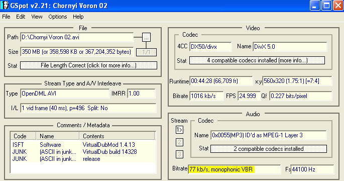

  26. Yes, I Know Roundabout's Avatar
    Jul 2003
    ...in and around the lake
    Originally Posted by Macfixer01
    Thanks for the good info. The one downloaded movie I tried re-encoding in DivX 5.1 did just what you say. The filename kept flashing and it never started playing.
    Macfixer,
    Upon rechecking the particular files I was talking about, I also noticed in this case that one was encoded at 71Kb/s VBR and the other at 77Kb/s VBR. The one encoded at 77 played just fine, the one at 71 doesn't play at all. They both were DivX 5 encoded but the lower bitrate made the difference. So if you are going to use VBR, make sure it's at least around 75Kb/s or it may not play at all.
    From GSpot, the file that doesn't play on LVD-2002:
    This one plays fine, (same series encoded by the same person):
    Ethernet (n): something used to catch the etherbunny
