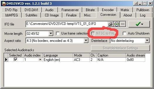

As far as I'm aware it DVD2SVCD will do an NTSC to PAL conversion for you:
It's greyed out there, because I don't have any NTSC discs to feed into it (only PAL ones).
I'd say it's worth looking into though - it's a brilliant app.
I think there's more about DVD2SVCD on doom9 than there is here, but a lot of the guides over there are linked to in the guides section on this site.
cheers,
mcdruid.
[edit] - sorry, just re-read your post, and you're trying to convert the other way around... I'll just see if there are options to do that or not...[/edit] -
