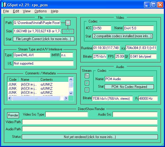

  2. what does gSpot say about your avi?

    Gspot image attached

    Trying again
  6. You might want to try something called the AVI FourCC Code Changer on that file.
    It seems that sometimes the FourCC code DX50 confuses apps - even although you do have DivX5 installed. You may want to change the code to simply DIVX and see if that works.

    Nov 2001
    Wow, the FourCC changer did the trick! Thanks
