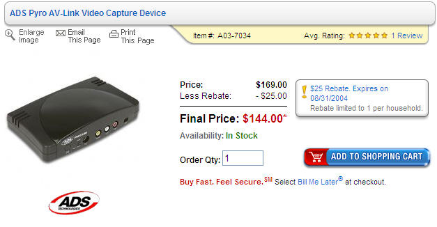

BTW, TigerDirect has the Pyro A/V Link for $144.00 A/R if you need one.
(Link)

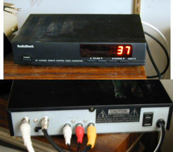

Hum. Wonder if it could be alter to change so to speak. Or even better, if possible, to still find one of those VCRplus controller for vcr? Looks like people have broken the code so you could do your own programming.
This sounds like a intersting project to combined a DV data signal along with a "IR" changer.
PS; It can be found for the under 150 price non rebate and even lower with a rebate! -
NightWing,
Yeah, I did some looking last night and haven't been able to find anything like what I'm looking for yet. There are a number of tuner units that output composite/component video along with USB2, but they aren't programmable. AverMedia makes some, even Viewsonic, but they aren't what I'm looking for.
All I need is a programmable tuner that outputs composite or component video and stereo audio. Seems everything on the market only outputs USB, or it's not programmable.
Basically, a VCR would do the trick, but I don't need the videotape recording part of the VCR, only the Tuner/Timer part, then output it directly to the component video input of the ADS Pyro A/V Link, into DV and onto the hard drive.
So far I haven't been able to find anything with that basic function. I don't need a USB unit, since I have the Pyro, and you'd think it would be easy to find something as basic as what's inside a $50.00 VCR - but it seems like no one makes something like that. I checked newegg, they have all kinds of tuners, most of them PCI internal units, along with a few external ones, but none are the type of unit I need.
I guess I'll have to do more research. Basically, every external tuner out there is not programmable, you have to be there to change the channel when the program comes on, which isn't practical when you want to record different programs on different days.
I may wind up having to buy a TIVO series 1 (older one that doesn't require subscription) just in order to get this basic function. I can't come up with any other ideas at this point.

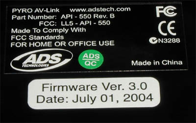

Anyone know if you can tell whether you will get a Rev C without opening the box? I'd think about buying one if I could find a really good deal like some of these folks that got one for $110-$120. Went by CC the other night...they had them on "clearance" for $179.

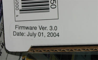

You have a good chance of getting a Rev C unit if the outside of the box shows that it includes UVS7 (or maybe they have even started putting UVS8 into the very newest ones? I don't know, but you could call and ask, they have an 800#). All of the Rev A and (afiak) a lot of Rev B units came with UVS6. Other than that, I am sure there are no other markings on the box that would indicate which revision is inside. I've looked already to try and determine the same thing you are trying to do (note my comments earlier in this thread about this subject).
The Rev B and C are the same, other than that a few of the Rev B units had the wrong crystal installed for PAL frequencies. Some of the Rev B units have the correct one, but if you're not working with PAL video you needn't be concerned with it. For that matter, if you get a Rev B unit and need to be sure it'll work with PAL sources, just call and speak to Jack or Adam in their Tech Dept., they'll be glad to test the PAL compatibility for you while the unit is in the shop for the F/W upgrade.
If worse comes to worst, you can return it to ADS like I did and request it to be replaced with a Rev C unit. I even ordered a 220v supply to use when I take it overseas, for an extra $10.00. They just included it in the package when they returned the unit to me.
Also, since most of the units out there have not been modified, but sitting on the shelf for several months, odds are you'll need to send it in for the F/W upgrade anyway. They upgrade it and put a sticker on the bottom indicating that it has been upgraded and the date.
Hope that answers your questions.
That's all I know about it thus far.

Also it looks like boxes are marked with the 3.0 upgrade along with a date!
Just got one but have no chance untill tonight to play around and do some testing with some test stuff.
NightWing,
I guess that'll make it easier for people to know the unit has the F/W upgrade, although whether it's a Rev B or C still can't be 100% determined until the box is opened.

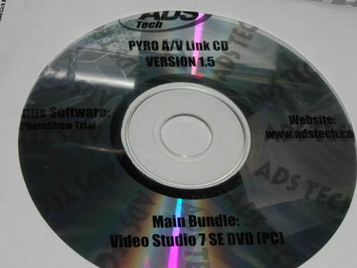

Did you get a Rev B or Rev C unit? Does it still come with UVS7, or have they upgraded to v8 yet?
Let us know how this box is working for you.
Thanks for your input!
RoundaboutEthernet (n): something used to catch the etherbunny -
Its listed as a B but has the revision 3.0 firmware. Here are some shots.
Bottom of Unit
Box end
CD. VS 7 SE and Version 1.5 of cd.
Will keep all informed.

Now we know it's still coming with UVS7. Good enuff!Ethernet (n): something used to catch the etherbunny -

re: VS8 in the box...
I don't think I've seen that there is an SE version of VS8 out yet. Considering that VS8 retails for $100 in the non-SE version, I'm not surprised it's not included. BTW, VS8 is an incredible piece of SW, especially good for creating DVD's from home videos and making them look and sound interesting. -
Doesn't matter. VS7 was bundled with Rev "C", and if you have it and want to upgrade to version 8, it will only cost $50.00.Originally Posted by pbandersHello.
