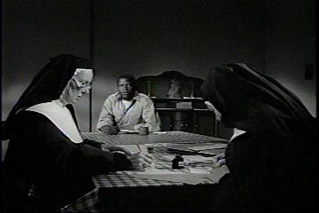

    Originally Posted by FulciLives
    Would be nice to know 100% if it can or cannot capture in B/W
    This is a commercial VHS DV capture (Lilies of the Field (1963), United Artists)
    Hello.
  8. Member FulciLives's Avatar
    May 2003
    Pittsburgh, PA in the USA
    Thanks for that confirmation TommyKnocker
    Good to know it CAN capture/convert B/W video.
    - John "FulciLives" Coleman
    Apr 2002
    The State of Frustration
    My pleasure.
