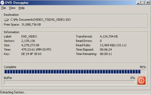

The DVD-R problem is fixed and it doesn't take forever to finalize a disk!With V2.16 the fastest I could rip a single-layer pressed DVD was 8x now it's 10.1x:
