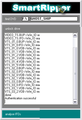

First insert your dvd and open smartripper, after the unlock box
opens and reads the dvd, smartripper main box will open.

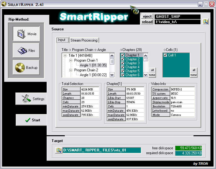

Program chain 1 should be highlighted, this is the main movie. and
all the chapters should be ticked. Also in the cells box, they should
also be ticked. also select where you want the new files to be saved in
the target box.

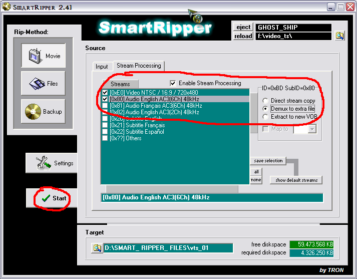

Now goto the stream processing tab
Make sure enable stream processing is ticked.In the streams area,
the stream with (0x80) audio english ac3 (XXX) 48khz is the main audio
stream. Make sure it is ticked, then click on it. In the area beside
it, select demux to extra file. This will make a separate ac3 audio
file. When done click start. It may take anywhere from 15 to 30 minutes
to complete the rip.

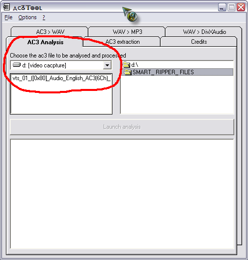

Open ac3 tools

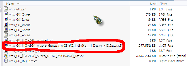

On the ac3 analysis, open the folder that you saved the ripped
files from smartripper in the dropdown box.Select the ac3 file, launch
analysis may work, i couldn't get it to, but it realy isn't
required.

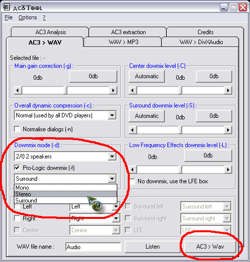

Now select the ac3 to wav tab
Make sure the ac3 file is highlighted in the ac3 analysis tab

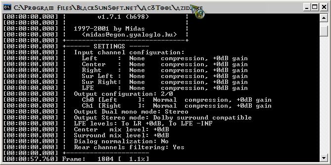

You can tweak the settings here or just leave them as they are,
just in the downmix mode, make sure the pro-logic downmix is ticked and
select stereo. you could select the others if you wish.
Hit the ac3>wav button,and the conversion will begin.

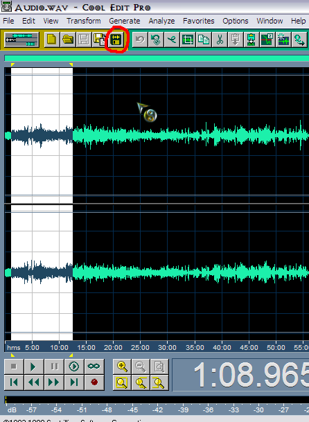

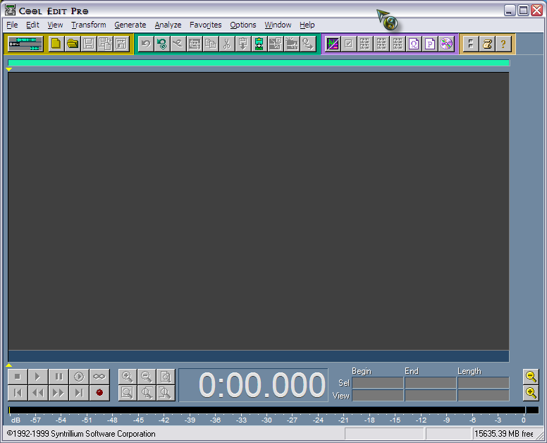

If you want to split the wav load cool edit
Load the wave file by clicking file,open.
Highlight the section you want to cut.
Save the section by clicking the floppy icon (circled in red), a
box will open, name the file and click save.

I also use AC3Tool....and you are the only person I've seen who mentioned that analysis was NOT necessary. After much trial and error I figured out that is not only un-necessary.....AC3Tool closes on me after Analysis. I just open the file in Analysis....then hit the AC3 to .wav tab and off we go.
