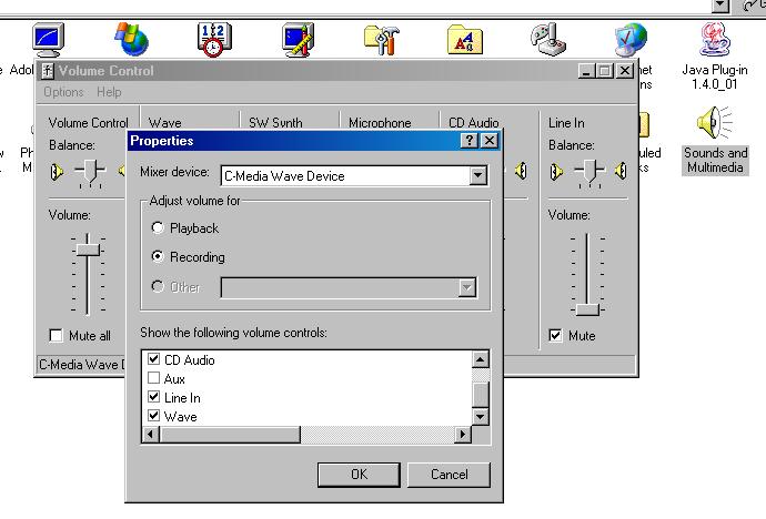

  5. Scuda, what you're looking for in the mixer properties depends on how you have the the cables etc.. plugged in for capture.
    As I said, I'm not familiar with the AIW, but I'd guess that the normal way of setting up to capture would be to have an s-video or composite cable plugged into the capture card to get the video stream, and then another cable (like a headphone jack) plugged into your soundcard - to get the audio stream. This cable is most likely plugged into the Line in on the soundcard.
    If that's how you've got it all plugged in, then it's possible that you can hear the sound when you playback the VHS, but that the PC is not set up to record that sound.
    This happens if you've got the level turned up for Line in in the Playback mixer (and Line in is not muted), but you have not got the level turned up, and the source selected in the Recording mixer.
    You saw the Recording mixer by typing in sndvol32.exe /r, and you can see the Playback mixer if you go to Options->Properties on the mixer, and change the setting:
    Like I say - this might not be quite how it works with your set-up, but it's a fairly standard way of connecting up for capture.
    So, if your audio cable is plugged into Line in, then you need to have Line in checked in the Recording mixer, and the level turned up to 90% or so.
    cheers,
    mcdruid.

  6. Druid,
    YOU ARE A GOD! It worked. Thank you very much for all of your help. Joecav, thank you also. I believe it was a combination of the two ideas that put me over the top on this one. One last question if you don't mind. It seems that the audio is coming out of only one speaker. In the capture options of DVDWS, I have stereo selected. I will play around with the settings and tried to improve upon things. But I'm very happy that I at least can record with sound. Thanks again!
