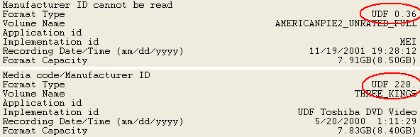

I think a lot of problems stem from NERO's interpretation of 'Standard' UDF format. They changed what the 'default' was on some 5.9.xxx revision. This lead to problems on the more finicky players. Creating an ISO image with IMG Tools eliminates Nero/RecordnowMAX/DVDDecrypter idiosyncrosies.
If you want true standards, then you would have to use a DVD5 ISO image. Pick some movie people would have, and is a full DVD 5 disk. You would burn it from an ISO image, using ...oh....pick a burning app.
Now the Media....that's easy. Only real RITEKs. I know there are other good brands, but we always come back to good old Riteks after making a bunch of coasters.
Burn it as -R, -RW, +R and +RW. That's 4 disks for a compatability test. This eliminates the Authoring software, then encoding software, actually it elimintes everything but DVDR compatability.
