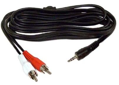

  5. I just recently purchased the same TV tuner/capture card for my dad to be able to record broadcast TV and digital satellite. The first thing I would do is check all connections on the PCI card. Make sure that the camcorder's audio is connected to line-in on the capture card and that line-out of the capture card is hooked to line-in on your sound card. Make sure that in the control panel that line-in is selected for recording and that the volume is turned up. This should be okay if you can hear audio using the card's TV tuner. You should also use a VCR to connect to the WinFast card's coax screw-on connector to see if that works okay for testing purposes. If the VCR works then make sure that all connections on your camcorder are secure. Make sure that the plugs are all the way in and that the leads are clean and fully inserted. If the VCR works but the camcorder does not then hook the camcorder up through the VCR to see if that works. If that does not work, then the problem is with your camcorder. For analog camcorders the right and left (red and white) RCA cords need to be combined using a RCA stereo to mini stereo adapter (it looks like a small stereo headphone plug on one end and has two female RCA audio connectors on the other end) before plugging in. I do not think that this cord came with the card, but I can't remember for sure. Your camcorder may or may not have come with this plug but probably not. Also check to see if you only have mono instead of stereo sound coming from your camcorder to see if that is the source of the problem. Definitely try hooking up a VCR by the coax cable connector first. You should be able to find the audio adapter at some place like radioshack, but beware that some salespeople may not know what you are talking about so be prepared to find it on your own.
    Or print out a picture like this one and take it with you when you go and buy it.

  8. Thanks for the advice the problem seems to definitely be with the lead I am using from the camcorder. Off to the shops (with the printed snapshot!) so hopefully all will be well. After that it is the vcr!

  9. Problem solved. The lead was the problem. Guy in Maplins Electronics Liverpool said a lead adaptor for £1 would do the trick and it did! Capture card works perfectly.
    Thanks again
