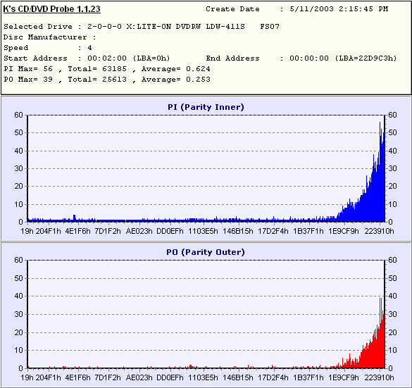

Rodfuji69 & Vanderlow,
Have run a TDK 4x +R with the DDW-081 and the following K-Probe scan. Outer edge jumps up in PI/PO issues but basically as a DVD-Video it plays fine. Full 4.3 gig burn took 8mins 30 secs. RICOHJPNR01 media looks fine at 8x on these units.
Read in Lite-On 411s at 4x max read speed. Scale for PI/PO is set at 60.
Media Code for TDK 4x +R
08 02 00 00 00 02 02 00 00 03 00 00 00 25 D9 CF .............%..
00 00 00 00 00 00 00 52 49 43 4F 48 4A 50 4E 52 .......RICOHJPNR
30 31 02 38 23 54 37 09 00 3C 67 00 AC 62 16 18 01.8#T7..<g..b..
0B 0B 0A 0B 01 19 1B 0B 0B 0E 0F 01 00 00 00 00 ................
Bit-setting utility inside DVDInfoPro and stand alone bit-set from nu work perfectly with the drive.

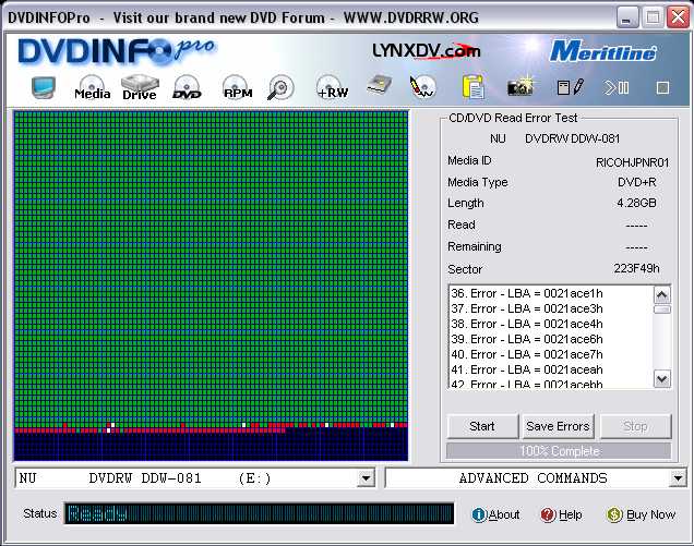

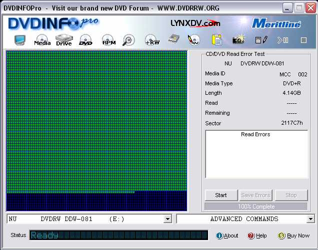

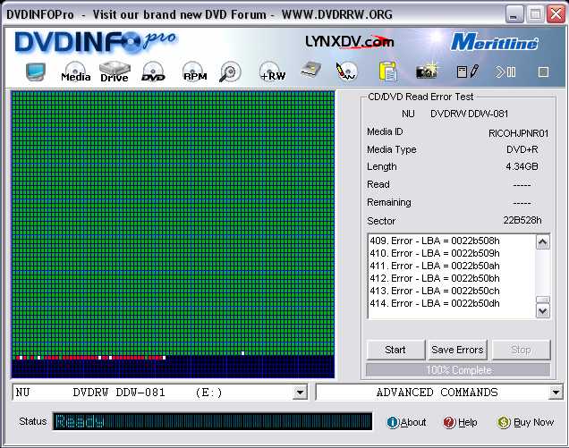

I only have The NU and a Pio drive installed. I removed my liteon dvdrom to install the NU dirve so I can't get Kprobe to work.
I did do some test with Dvd InfoPro though.
All disks were rated 4x written a 8x speed
the Verbatim disks had 0 read errors and the 2 Tdk disks had quite a few errors towards the end of the test. The errors started with aprox .02GB left to read on the disks.
All three disk function perfectly as a dvds with no pixelisation,skipping,or pausing from begining to end in all of my stand alones and my computers dvdrom drives.
Verbatim 4x mcc 002
TDK 4X RICOHJPNR01
TDK 4X RICOHJPNR01
No the blue part is not part of the read
I edited my last post with more captures -
Rodfuji68,
I can concur with the results you've seen so far. The Verbatim 4x (MCC 02) discs seem to give a slightly better result via error scans etc. They both will run fine in any players I have tested with, especially after setting to ROM. All in all i'm pretty happy with results from the unit.
