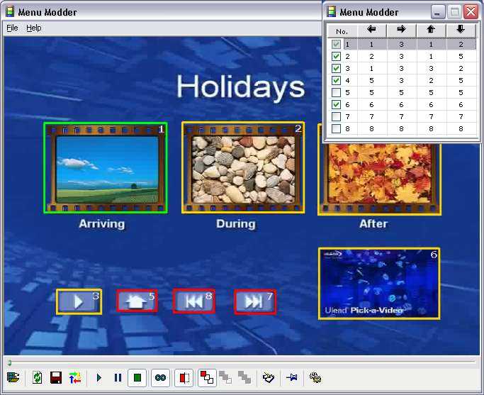

there is a 'free' method now
you can use DVDStripper to strip anything you want or split the discs. Using MenuModder as a preview player you can then disable the buttons to the items you have removed just by right clicking a button
and it's all completely 'free'
the only cost is your usertime which shouldn't be that long for most
I don''t have a direct link just yet but you can download the 2 programs here
http://www.dvdrbase.com/showthread.php?t=36468 -

However, there is a better method available now that DVDStripper is freeware. And the menu plays first automatically. Read the tutorial on the download site, it'll take all of 5 minutes. All you have to do is select the main movie and all menu items, done. Or use MenuModder in conjunction with DVDStripper if you wish to modify the menu.
To make the DVDStripper method work, you'll also need DVDDecrypter and IFOEdit. All freeware. Good luck.Pull! Bang! Darn! -
