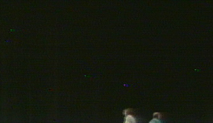

    Anyone have experience/recommendation on how to remove multi-colored random video noise or dots from captured video coming from a laserdisc of deteriorating quality ? VirtualDub filters ? or will re-capturing using an external TBC help the problem?
    Longer version:
    I captured an older laserdisc ("Genesis Live in 1976") to DV video (Canopus ADVC-100), ran it through Tmpgenc and burned to DVD. Then noticed typical signs of "laser-rot", i.e. multicolored random noise or specs in the picture on the DVD. Went back and checked the laserdisc and the DV capture file and it's there as well (so it wasn't the transfer process that introduced it).
    So what's the best way of reducing this (chroma?) noise ? Since the video is letterboxed the red green and blue dots show very clearly in the "black bands", but at the same time should be easy to detect and filter out. I have an external TBC (DataVideo TBC-1000) that I can hook up and do a re-capture (using Y/C video signal chain) but will that alleviate this kind of problem ?

  4. It's simple and easy to remove laser rot from captured video. VirtualDubMod with a moderate setting on the Temporal Smoothing Filter (3 to 6) out of 10).
    To eliminate laser rot on the black areas of the letterboxed screen, encode the video in TMPGenc using the CROP option with MASK enabled. Set the mask at top and bottom so it just covers the black letterboxed rea above and below the picture.
    Voila! No more laser rot.

    Tried hooking up the TBC in the signal chain, apart from a slightly more "stable" picture, the "laser-rot" was still as evident.
    I tried the Tmpgenc CROP option and that gave a seemingly good result (I didn't burn to DVD just did a quick re-encode and checked it on the puter).
    So I'll do a "full" re-encode with Tmpgenc CROP and burn and check again. I think just "masking" out the multi-color crawling dots from the black bands will take the beholders mind of the fact that there's "laser-rot" present.
    But I do have another "4:3" laserdisc with much more severe laser-rot where i'll try the VDub filtering approach as soon as I have time to cap it.

    Yes, the re-encode with CROP in tmpgenc did mask the problem somewhat, but it's still visible (at least to me who knows it's there).
    So, I have downloaded and tried about a dozen different VirtualDub filters, but have yet to find a filter/settings that will remove these "dots". Temporal cleaners included.

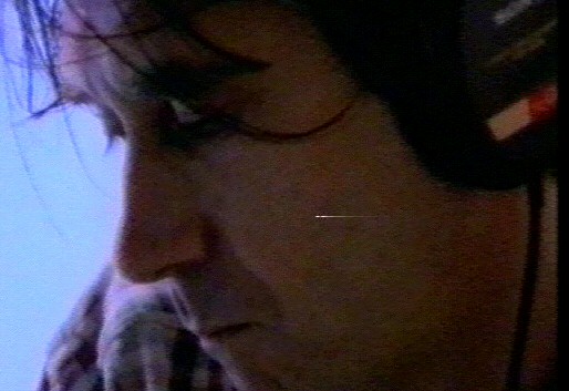

    Also a similar problem popped up (no pun intended) when I captured some VHS that had very typical "drop outs" in the signal. They manifest themselves as white streaks or "horizontal drops" in the pics. Those I haven't been able to filter out either, though there are many great VirtualDub filters that will clean up a "VHS signal" considerably.

    A) VHS "drop outs"

  8. For the VHS Drop-Outs, I had that same problem and a good cleaning of the VCR heads fixed it.

    You might try the Undot filter in AVISynth. It is primarily for signal noise and removes single pixel noise by blending in the surrounding pixels. I use it on all of my 8mm tape to DVD conversions and, though it certainly doesn't perform miracles, it does help.
    I would suggest going to avisynth.org and looking at their extensive filter list and documentation. There may be something there that works to make it worthwhile doing.

    The Conditional Temporal Median Filter for avisynth or MJPEG Tools may fix the VHS dropout.
    Read more here:
    http://kevin.atkinson.dhs.org/temporal_median/
