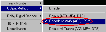

Set "Decode to WAV" in the audio submenu.
If you want to downconvert the audio to 44.1 Khz set "Ultrahigh" or just leave it off.

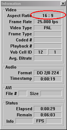

Now you're able to see if the source is 16:9. And yes, it is!

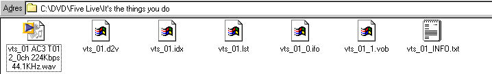

Wait untill the project is finished. If everything is alright your folder would be like this:

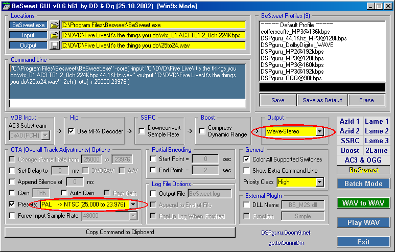

2. Framerate convert your audio with Besweet.
Be sure your output has a different filename then the input. Or you'll might get confused.
I recommand a "Wave-Stereo" output. You must be sure that the "presets" is set at: PAl -> NTSC (25.000 to 23.976).
To start conversion, click on "Wav to wav". The process will take some time.

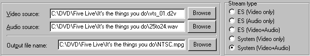

Open your *.d2v file under "video source" and open your audio converted by Besweet under "audio source". The output is your choice.

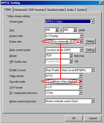

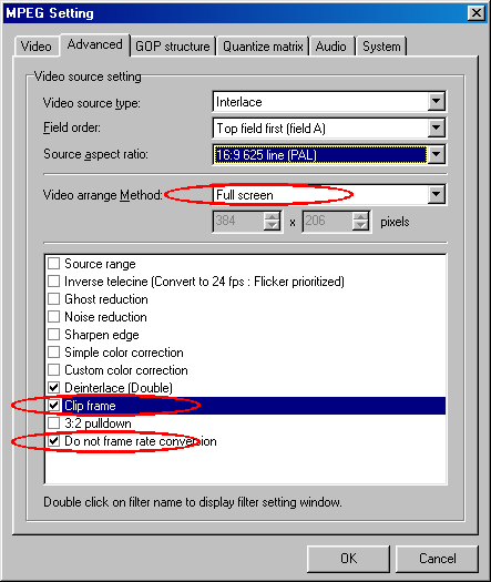

Under "settings" you must have this:
(You can also do this with CVD or DVD with CVD resolution you only have to change the resolution to 352x480)

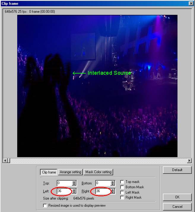

Under advanced you must select "Clip frame" & "Do not frame rate conversion". If your source is interlace you must deinterlace them. Because 3:2 puldown when playback only supports progressive.
"Clip frame"
Be sure 36 is set in both left & right. Now you're losing 10% of the image.
You can see the source is interlace... The jpg compression makes it hard to see!

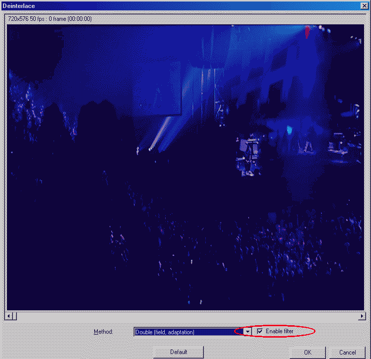

"Deinterlace"
Be sure the filter is enabled! Use your preferred deinterlace method. Push the "OK" button. Push the "OK" button again in the settings window.

Help....I can't get the framerate setting right. the 23.976fps (Internally 29.97 fps) I don't have that in the pull down and tried messing with the settings tab as well.
thanks

maybe I got ahead of myself....The only files after doing the first step... the only files I have are 2....mat AC3 T01 3_2ch 384Kbps 48KHz.wav 1,492,075kb and mat.d2v 571kb.
Was trying to convert Matrix pal to ntsc -
@casba: It's possible you have only the files outputted by DVD2AVI. Cause you might select another folder then the foldere where the vobs & ifos are stored. Add me to your msn: freezethemoment@hotmail.com.
