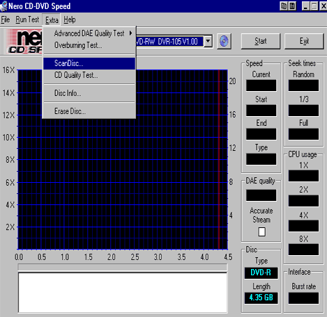

    Start the program and go to EXTRA and then select SCANDISC

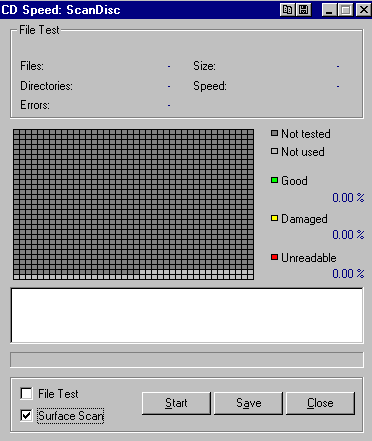

    This window will appear:
    Enable SURFACE SCAN only and then click START.
    When it is done, red means the disc is bad, yellow means it may or may be bad at that spot, and green means good.

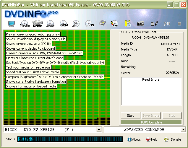

  2. Or use DVDInfoPRO. Most of us have it anyway... www.dvdinfopro.com

    I used DVDInfoPro for doing the READ ERROR TEST
