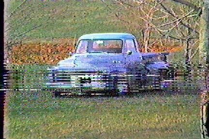

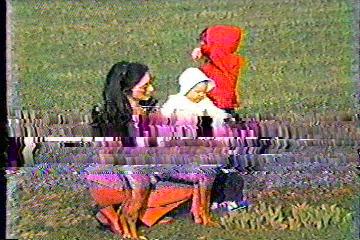

I'm trying to capture a 21 year old vhs tape with my DAC-100. It is doing a remarkably good job, but the first 20 minutes or so of the tape is giving my vcr grief that I believe is due to tracking. When the video jumps, it drops frames. It also has tracking lines that come and go as shown in the pics below.
My vcr is a cheap 4-head GE brand. Will a better brand improve my problem or do I need a TBC (or a vcr with built in TBC)? I'm trying to find a better vcr for testing, but all of my friends also have cheap vcrs. I appreciate any suggestions you have to give.

Your images indicate distortions in picture content as well as timing.
A TBC will attempt to eliminate the timing errors, but can do nothing about the loss of actual picture information.
Also, while the TBC will continue to provide valid video fields to your DAC-100 (and thus eliminate dropped frames), video jumping may still occur as the TBC resyncs its own input capture. I would hesitate to claim that the result would be better. It could be just as bad or even worse. The more important issue is to eliminate the tracking problems as much as possible. A TBC can't help with that. A good ol' VCR built around 1990 may be your best bet. -

So those ugly distortions in the pics are due to "picture content" rather than tracking (or are you referring to something more subtle)? A friend of mine has a Zenith that he bought about 9 years ago for $250. Maybe I'll ask him if I can test on it. Do you have any opinion on the Panasonic AG-19xx series SVHS editing vcrs (specifically AG-1960)? I've seen a lot of those for sale.

Take a look at the second image again.
The distorted lines are not only misalgned horizontally, but they are full of noise instead of picture content.
Even if the external TBC retimed these distorted lines perfectly, this region of the picture would still be noise.
The picture content needs to be recovered before an external TBC can help.
BTW, the sync region is blacker than black, not whiter than white. -

Thanks for the comments. The distortion area in the pics I posted got distorted a little bit when I shrunk them to put on this forum (distorted distortion?). In other words, that area looks a little different than the original (oh, so little). The second one is most like the original.
