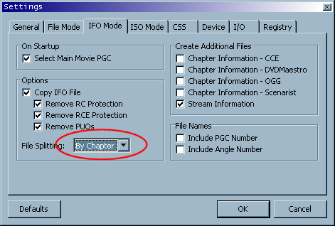

    If you tell DVD Decrypter to split output at chapter points (Tools -> Settings), and the DVD is authored with chapter points at each tune (which seems to be the usual way to do a music/concert DVD) you'll get one VOB / chapter/tune.
    Now, run each of these VOBs, one by one, in DVD2AVI to get one wav each tune.
    /Mats

    Didn't seem to work jst got 1 VOB file, but what i have managed to do is ripped the audio stream using DVDdecrypter, conveted it to WAV using goldwave, then tried splitting the tracks using Audacity, that all worked fine but when i try to write it to a cd i get a error saying that "the file blahblah.WAV cannot be recorded to your disk because it is not in the correct format"
    Is there an easier way to split the tracks if there is PLEASE HELP cause im a complete tard and can't work it out for myself!?
