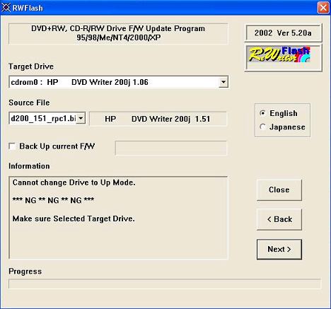

oki this is the message i get when i try to update the firmware to 1.51
Cannot change Drive to Up Mode.
*** NG ** NG ** NG ***
Make sure Selected Target Drive.
Whats the chances doing this that it will wreck my writer anyway?

Can you post a screenshot of the Flash Program when the drive and the firmware selected?You stop me again whilst I'm walking and I'll cut your fv<king Jacob's off. -

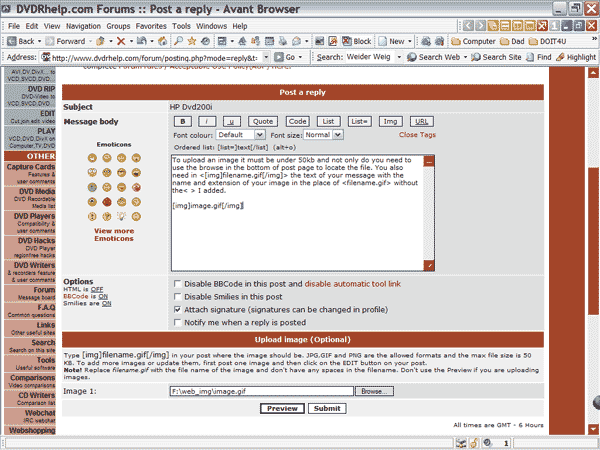

To upload an image it must be under 50kb and not only do you need to use the browse in the bottom of post page to locate the file. You also need in [< >img]filename.gif[/img< >] in the text of your message with the name and extension of your image in the place of < >filename.gif< > without the< > I added in all places.

here you go...
