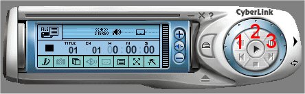

    Originally Posted by rhegedus
    PowerDVD allows you to play media files and advance frame by frame after you've paused the clip at any point.
    I couldn't figure how to do this
    Will
    tgpo, my real dad, told me to make a maximum of 5,806 posts on vcdhelp.com in one lifetime. So I have.
  16. Member rhegedus's Avatar
    on the jazz
    1 - Step backward (CRTL-B)
    2 - Pause (SPACE)
    3 - Step forward (T)
    Works with mpegs, don't think it works with avis.
