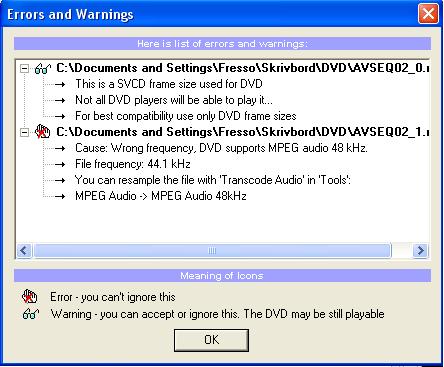

ok ressof, thanks for that. I have just set SVCD2DVD on the sample and got the old demux not stopping thing (due to the way the sample is cut). So i used the bbDMUX option in the configuration & then it works flawlessly.
The results are in that folder (ftp)

And can you try SVCD2DVD on the sample (need to rename it to AVSEQ02.mpg) - but use the bbDMUX option.
ThanksSVCD2DVD v2.5, AVI/MPEG/HDTV/AviSynth/h264->DVD, PAL->NTSC conversion.
ressofGuest
the file i uploaded was an sample of the first move demultiplexed and multiplexed again with tmpgenc but with the same result with svcd2dvd
The sample file worked just fine with bbdmux but i have used mpgtx for the other files. It works with the original movie know when i have used bbdmux. But why cant i use mpgtx?[/i][/b] -
